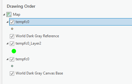

So this works great in that I'm getting a symbol plotted where I needed. But it does that three (3)  times giving me the following output.
Now, I realize I could try and control the place of insertion by using addLayer() and using the LYRX file directly after updating its data source. But the above output is not what I would expect based on what I'm doing. What's going on there?

Line #01 and Line #04 call the exact same geoprocessing tool, so you should expect them to both work.  Line #01 represents the new syntax that Esri is pushing with Pro while Line #04 represents the original/legacy syntax.
The default for arcpy.env.addOutputsToMap is True, and I am guessing you are using the defaults, so lines #10, #18, and #24 in your code snippet will all add layers to the TOC, which is what you are seeing.
