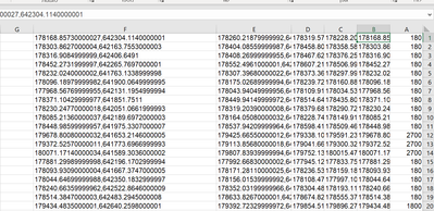

OrRubinstein
BlakeTerhune
MVP Alum
It's hard to get the full picture of what's happening with this screenshot. It would help if you could post the raw text of a few rows (with header row).
From what I can see here, column A is your "Id" field? Is there a variable number of point coordinate columns? Also, I see you're creating a "SHAPE@" field in the shapefile. That's not how that's intended to work. It's what's called a field token. It's not a field name that actually exists.

OrRubinstein
thease are the first 2 rows, the coloumns are from left to right:
180178168.85730000027,642304.1140000001178228.20880000014,642355.0789000001178319.57019999996,642248.6835999992178260.21879999992,642197.7185999993178168.85730000027,642304.1140000001
180178303.8627000004,642163.7553000003178358.5828999998,642219.6634999998178458.8058000002,642121.5704999994178404.08559999987,642065.6622000001178303.8627000004,642163.7553000003
Column A is Floor area and the rest are coodinates (x,y in every cell). the Id added automatically to the table, i'm not sure how but i can see that on arcGis pro. The variable for the id it "cnt".
