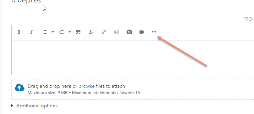

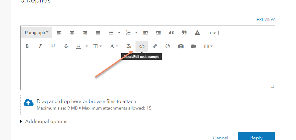

That is a lot of code for someone to try to figure out all the indents, etc.
Might get more responses if you edit the post and paste the code in using the code formatter:
R_
