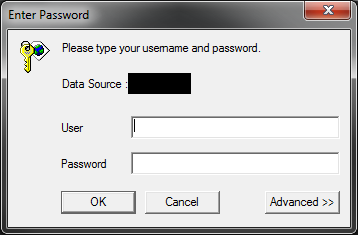

I need to re-point all sde raster layers in mxds to a new sde instance (we are moving from sde 9.3.1 to 10.1). Many people have also have ODBC connections within their mxds for tabular data from non-spatial databases. The problem is when I run the script it is constantly prompting me for credentials. I could care less about them for this exercise as I do not need to update the ODBC connection. I would like to just suppress them. Can this be done?

I do not need to update the (non-sde) connections that are causing the Enter Password dialog. They are fine. I just need to update all raster layers in the mxds that point to one sde schema, sde_user, in the code. This part is working, if I just hit cancel on the dialog the code completes and successfully updates the target connections. The problem is that one just has to sit there and hit cancel over and over. Something like 40 times for my test set of mxds. The other option would be to some how pass my credentials to the dialog.

It is a non-sde connection that is causing the problem.
forestknutsen1
MVP Alum
Any one know how to get a list of only raster layers in a mxd without using arcpy.mapping.ListLayers(mxd) as it looks like it the dialog is occurring when this object asks for info for the non-sde layers?
