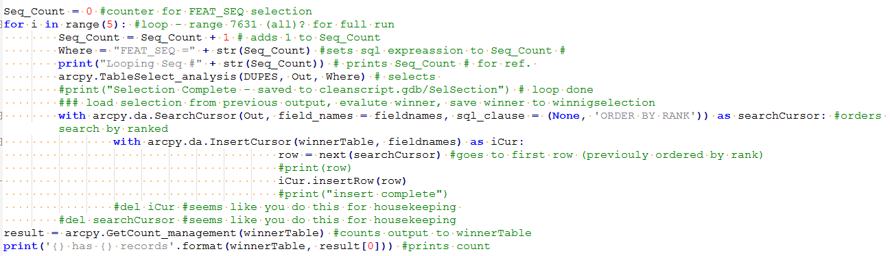

I am working on a script that is attempting to use ORDER BY. The results I'm seeing are unordered. I've dug quite a bit in GeoNet and elsewhere to no avail. My data is in a FGBD, my understanding is ORDER BY should work...
I'm hoping that there is something wrong with the logic in my script, and someone might help me identify it.
In a nutshell the script selects a group of features based on FEAT_SEQ, the selection is then sorted by a RANK field (NOT WORKING), the first row is then written to a new feature class. All of this is working except for the ordering. The output simply writes the first row, unsorted.
  • The TableSelect, selects features in a FC by the FEAT_SEQ field. The FEAT_SEQ is a result of the identify duplicate tool.
  • This selection is intended to be "sorted" by the ORDER BY using the SearchCursor
  • Finally the first row is written to a new FC

The sql_clause is on line 9 (shown below)
with arcpy.da.SearchCursor(Out, field_names = fieldnames, sql_clause = (None, 'ORDER BY RANK')) as searchCursor:
screenshot of same code (in case it is easier to read)

JoshuaBixby
MVP Esteemed Contributor
Your problem is this line:
Out = r"in_memory/Selection" ‍‍
In-memory workspaces, both the legacy in_memory and newer memory, are not full-fledged geodatabases.  The newer memory workspace does support more geodatabase functionality than the older in_memory, but Esri doesn't clearly document all the improvements in the newer workspace.
I did some quick testing, and SQL ORDER BY is honored using the newer memory workspace.  If you aren't using ArcGIS Pro already, I encourage you to switch and also switch to using the newer in-memory workspace.

WesleyGarrett1
Thanks so much! That was the problem. I switched to outputting to a GDB for the selection and everything worked as it should. Unfortunately I can't use Pro for this in the long run. We don't have the option at this time for enterprise applications.
Good new though, it is working, albeit a little slower than it's already snails pace.
