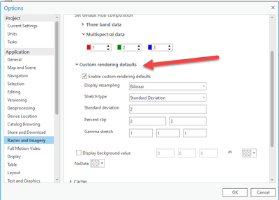

I believe the resampling method environ setting only applies to GP tools that honor that setting.
When you set Resampling Type in the Raster layer Rendering tab as in your attached pic, that is only for displaying the raster, and doesn't change the data at all.
You can change the default method in the options so that it will always render raster with that type, but don't know of a way to get at this with code.
R_
KristieReece
I updated those settings as displayed in your image, unfortunately, it still does not provide the smoothed visual that the rendering tab setting achieves. Thank you for the info! I suppose we will just have to edit that setting by hand.
