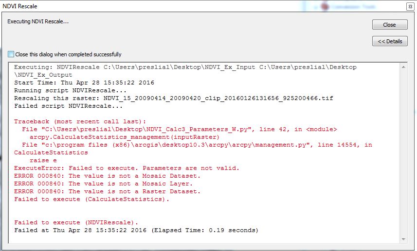

I have a script that looks in a folder for all the rasters it contains, performs simple operations on those rasters, and saves them as new rasters in a new folder. The script works fine in ArcGIS 10.2 with python version 2.7.3, but gives the following error in ArcGIS 10.3 with python 2.7.8.  The script is embedded in a tool, i.e. not standalone in python.
I've attached example input files, the script (entitled .NDVI_Calc3_Parameters_W.py), and its associated toolbox.
The script fails at:
    arcpy.CalculateStatistics_management(inputRaster)
Troubleshooting has lead me to believe that someone it no longer recognizes the input as a raster.  I've tried various workarounds (including removing the build attribute table line before that one, creating a raster object, etc.) but I still can't get it to work.
Any ideas?
Thank you in advance for any help you provide.

I agree with Andrew's suggestion. These file names are really long and you can run into issues when the entire pathname gets beyond a certain number of characters. When a raster object is passed to a tool, its full path gets expanded (because its str() method returns the full path). Layers are safer because they are nice and short and can be passed directly to the tool without having to handle the path.
