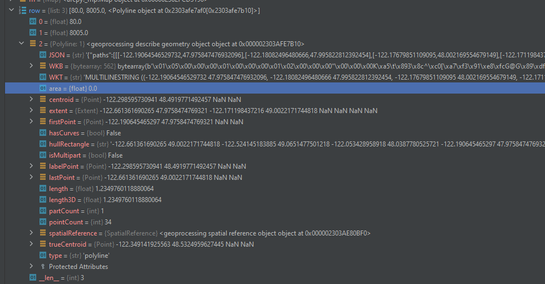

When you use the @, you are accessing the geometry object so when you cast it to string, you are getting the string value '<geoprocessing describe geometry object object at xXxx>'. Since memory is recycled, this could be causing false positives for duplicates and deleting the row because xXxxx is a place in memory and it will always contain the 'geoprocessing describe geometry object object at' part. For example, when looking at it in the debugger your row_val is:
If you look at the Shape@ at row[2] in the debugger, you can see its object properties:
Going back to using Shape, that row[2] tuple is nowhere in the SHAPE@ properties.
It would be interesting to see where that coordinate plots to along the line...
How do I amend the remove duplicate appends script to get all the duplicates?
If you wanted to continue with the script, access the Shape@ geometry properties and such as firstPoint, lastPoint, trueCentroid and use those for comparison.
