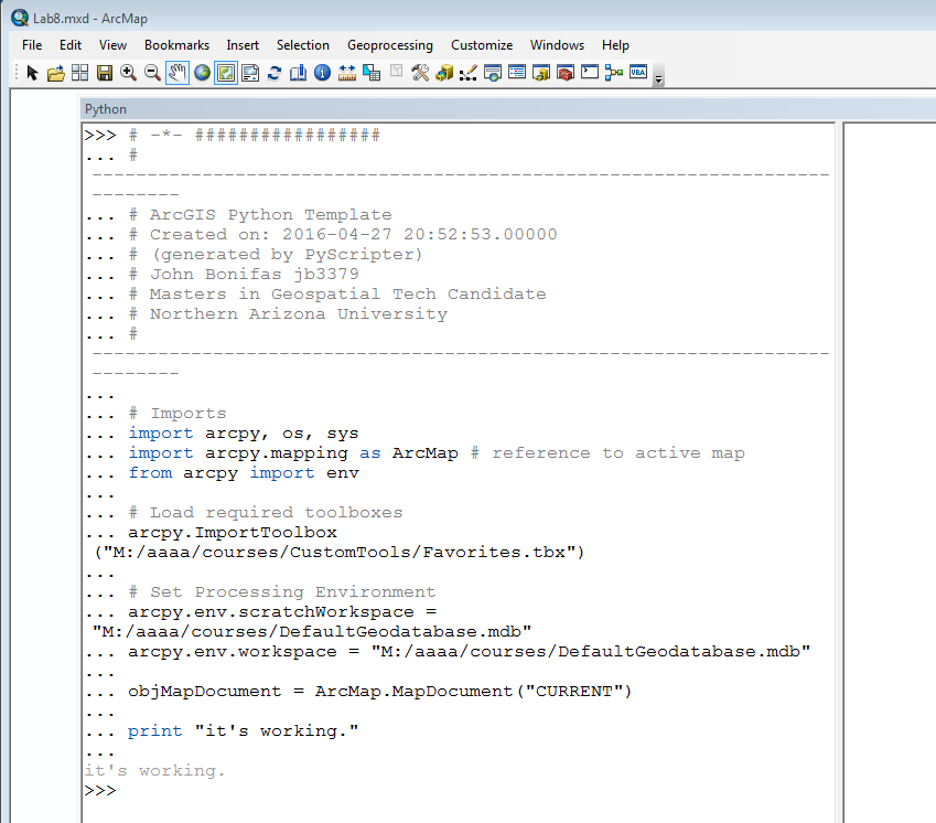

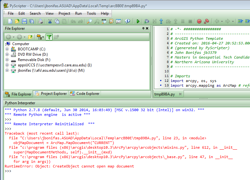

...If I try to set a reference to the currently open map in ArcMap, it will work in ArcMap's python console, but it will not work in PyScripter:
I really hope that I'm just doing something wrong, otherwise I lose the great benefits I get from writing and debugging code in PyScripter.

Sorry -- the PyScripter Python process is separate from the Python process under ArcMap - so it definitely can't access a "current" document. You could work with a saved .mxd document, but you can't interact with ArcMap from another Python session.
The way I test tricky things in arcpy.mapping is by trying them out using ArcMap's Python command window.
