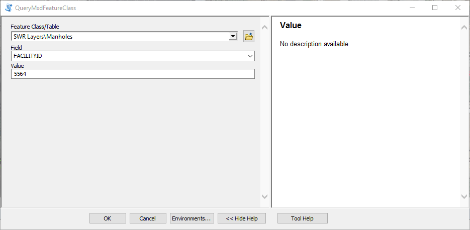

I get the following message, don't know what is wrong.
Executing: QueryMxdFeatureClass "SWR Layers\Manholes" FACILITYID 5564
Start Time: Mon Feb 06 15:41:32 2017
Running script QueryMxdFeatureClass...
Failed script QueryMxdFeatureClass...
SyntaxError: invalid syntax (QueryMxdFeatureClass.py, line 19)
Failed to execute (QueryMxdFeatureClass).
Failed at Mon Feb 06 15:41:33 2017 (Elapsed Time: 0.67 seconds)

InputFeatureClass = arcpy.GetParameterAsText(0)
InputField = arcpy.GetParameterAsText(1)
InputValue = arcpy.GetParameterAsText(2)
whereclause = """{} = {}""".format(arcpy.AddFieldDelimiters(InputFeatureClass,InputField,InputValue)
arcpy.SelectLayerByAttribute_management(InputFeatureClass, "NEW_SELECTION", whereclause)
df.zoomToSelectedFeatures()
arcpy.RefreshActiveView()

DevinUnderwood2
Oh didn't catch that. I changed it.  I am unable to use print statements to test it out since I am running it as a tool which doesn't return print statements.
whereclause = """{} = {}""".format(arcpy.AddFieldDelimiters(InputFeatureClass,InputField),InputValue)
