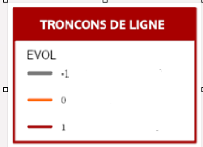

Hi everyone,
I developed a Python script to automate the generation of maps in ArcGIS Pro based on various parameters.
In my layout, I want to be able to modify the LEGEND_Item, but all my attempts have failed so far...
In fact, in my legend, I only want one layer to appear, while the others should be hidden (in the legend only).
My code does allow me to hide the layers I don’t want in the legend, but the one I do want appears 3 times in the legend. I should mention that it is inserted only once in the map. Its symbology is based on unique values, and there are 3 unique values. I suspect this is related.
Here's my code and the result:

Also want to get rid of the label "EVOL" and change the text for each value (ex. 0 should be replaced by "Unchanged value".
Any idea on how to do it if possible?

Your symbology is unique values, so the legend automatically lists each unique value as a separate legend item. Try changing the labels for each unique value (0 → "Unchanged value", etc.), showHeading = False - Hides the layer name ("EVOL" in your case).

That exactly what I suspected : the legend displays each unique value as a separate legend item.
I'll try changing the labels for each unique value but once it is done, do you know if  there is  a way to get a result that looks like that? (just one item displayed in the legend)
