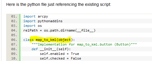

I have been playing with the Python Add-In Wizard, and I have created a toolbar with some menus and buttons.  I am having trouble getting the buttons to work, though.  I've followed Rebecca's instructions (here: Python add-ins vs. .NET add-ins?​), as well as the attached PDF to try and use an existing python script within my toolbox, but the button just shows up as missing when I install the add-in and run ArcMap.  I've even tried pasting the entire code from the script directly into the onClick function, and that just does the same thing.

I did notice though that your id= values don't match the "class" names in the original <project>_addin.py file
I think ButtonClass1 is the default, and in your _addin.py file you show map_to_kml    You may have more than that that isn't showing.  I have those two items batch in my addins.
Also, just fyi, most have mine have been for Catalog, not ArcMap, so there may be things I haven't run into.
Try to see if making thing match up helps.

The mismatching is due to me creating a whole new project thinking that there may have been an error somewhere down the line that I didn't notice.  I created a whole new project so that the *_addin.py file would be default (thinking that the default file would eliminate any syntax errors).  I've been using the MessageBox example as shown above just to test, but the button still shows as missing even if I don't add the MessageBox function.  I can generate a completely default *_addin.py file, create/install the add-in, and ArcMap still shows a missing button.  There can't be any syntax errors if I haven't even typed anything into the file...something has to give here lol.
