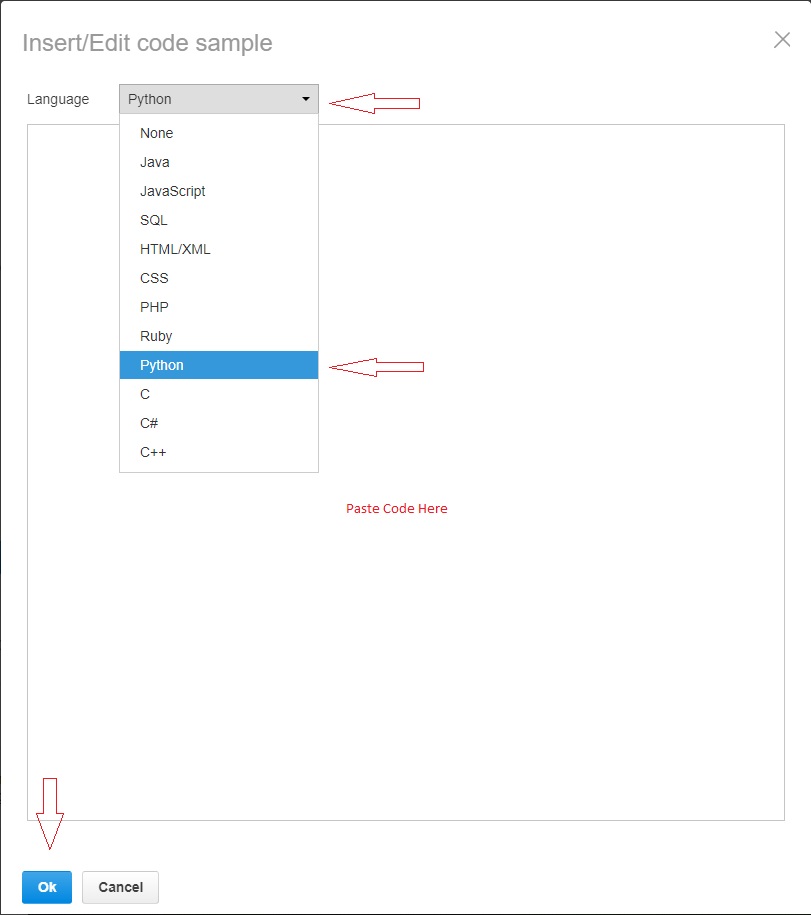

Gasper Can you please post your code using the syntax highlighter which helps preserve format and indentation. To do this click the 3 dots:
Then click more and choose Syntax Highlighter:
Then choose Python from the language drop down menu, paste your code and click Ok
