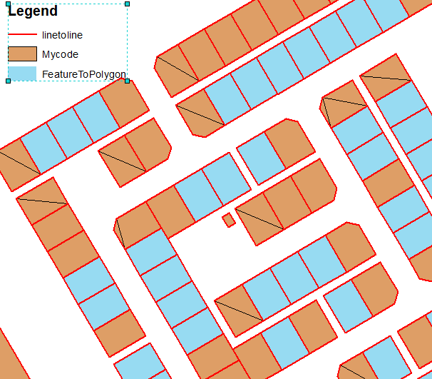

I am trying to convert a ploy line feature class to polygon without using Arc info Advanced Licence.The code i am using runs fine and converts polyline to polygon. I have run the "tool feature to polygon" to make a comparison.My code is not converting all lines to polygon(See Screenshot).I have also attached my code.please guide me to get the same results.
Polyline :Red(to be converted)
Mycode:Brown
Feature to polygon: Blue

I am displaying each polygon vertices and coordinates. The problem is that some line features have only two vertices (starting and ending) .My code is not converting them as it is not a polygon(we need at least three vertices).Please guide me to convert all lines as feature to polygon tool is converting.

I know about these tools.My main concern is about the result comparison. I want to know the logic behind feature to polygon tool?there is something missing in my code.
LukeWebb
Put Simply, feature to polygon considers ALL INPUT FEATURES when creating shapes, and is a more complicated totally different algorithm than what you have begun to implement with your  "Feature by Feature" code.
You could look to dissolve the input lines, and then explode, as a pre-process, and then rewrite your own algorithym, but its probably a little complex to get good results!
