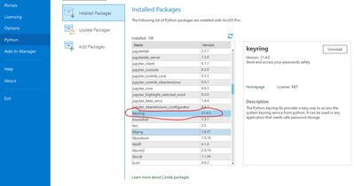

Hi All - I found that a previous version of keyring is already installed in Pro (see pic).  Is it necessary to Pip install keyring if Pro is available on the machine where the script will be executed?   I tried cloning the environment, but couldn't update the keyring version (will come back to that).  Anyway, for simplicity sake (apart from the version) is there an issue with using this already-available package?
