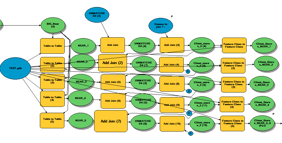

What I need to do: 1- I want to create a table with all the data from the 25 near tables and the 25 census table
to do that I have to:
a)join the unmatched FC with the NEAR1 table
b)join the result FC of step a) with the census FC
c)repeat the same step for all the near tables and join the census on each one
2- using model builder I used something like the snapshot below
Notice that the output of every line is the input for the next one
3- I am trying to write a python code to do the same but I am really struggling with it, I think it might be something like this:
