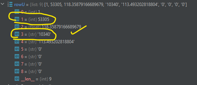

That's a good improvement! If you still want to save some time, you can use multiprocessing and create all 4 dicts simultaneously...
I'd start with checking the data type of rowU[3]. It looks like the keys in that dict are ints, so if rowU[3] is a string, there won't be a key match.  You can cast it to int() if its Text, or cast the key to a str when you make the dictionary.
PS, u can use the f decorator in your prints and make it a little more concise and readable:
print(f'after: {rowU[0]}, {rowU[1]}, {rowU[2]}, {rowU[3]}, {rowU[4]}, {rowU[5]}, {rowU[6]}, {rowU[7]}, {rowU[8]}')
DominicRobergeIADOT
that was it:
I add a cast to int and everything started working as expected. Thank you so much for all your help
