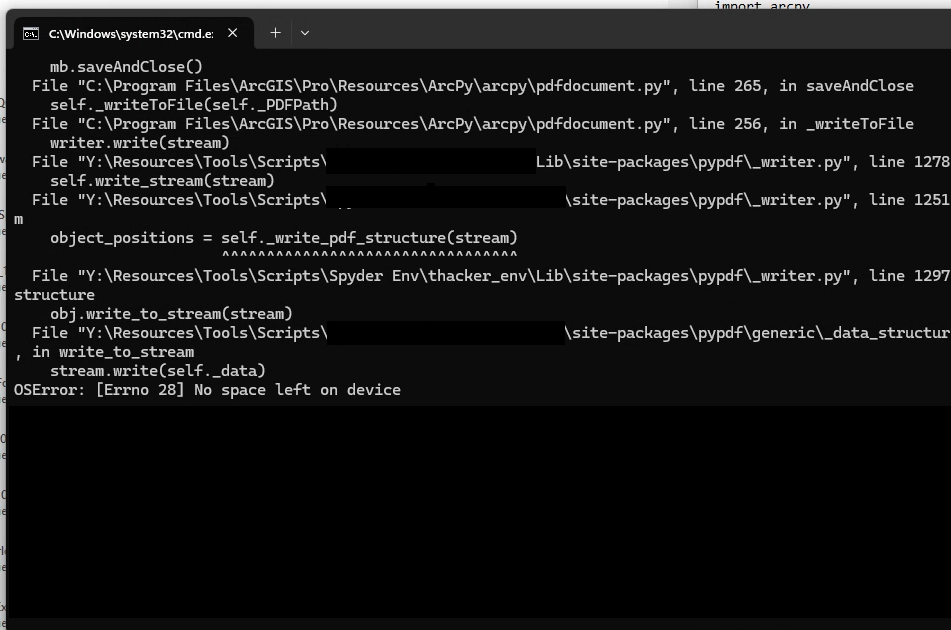

Hello,  I'm running into an issue where a plotting script I have runs fine on a local laptop where Office365, Adobe, etc are all licensed and running fine.  But when I try to run the same script in a remote VDI environment, the script fails at merging the pdf files to a single file output .
My question can merging pdfs (merge_pdf) in a script have a dependency where Adobe needs to be installed and fully licensed prior to running the script in a VDI environment.  I've added screen capture below but from the error it looks like its trying to write but can't.  As for drive space, I have over 200gig free files are small and ram utilization is less than 30% used.
ArcGIS Pro 3.5.3 is fully installed and licensed to run  -  Adobe reader is installed
