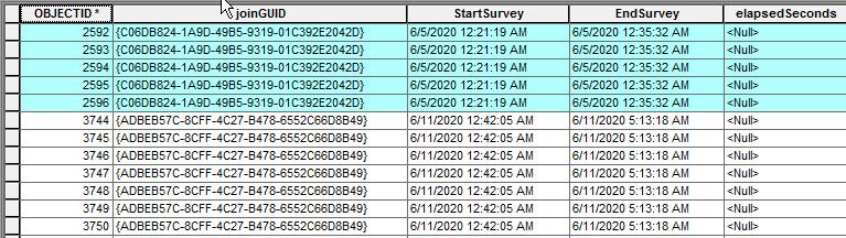

I need create a list of unique values from multiple date columns ("startSurvey" and "EndSurvey")...(I guess a list of lists is fine as long as I can iterate over it and grab the 2 unique values). In the end, I am trying to build sql for a separate SearchCursor.
The desired result of the example needs to be:
[[StartSurvey: 6/5/2020 12:21:19 AM, EndSurvey: 6/5/2020 12:35:32 AM, [StartSurvey: 6/11/2020 12:42:05 AM, EndSurvey: 6/11/2020 5:13:18 AM]]
It doesn't necessarily have to be list of lists like this, but in some way that I can easily iterate over it to grab the unique StartDate/EndDate valules.
