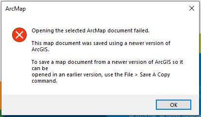

I've also tried just leaving off the optional version parameter. The script tool will run, but when I attempt to open the new MXD, it has not been saved down and tells me that the MXD needs to be saved down using Save A Copy.

But this did help me figure out my answer. The 'default' version parameter None was being passed when I left the optional version parameter field in my script tool blank. But I suspect that when the default is passed, the saveACopy method does not detect your installed version and remove functionality to save the MXD at that version level; instead it just uses the Save As function and updates the file name. This is indicated by the fact that new MXD grows in length by 1 KB (proportional to the longer file name?) instead of being reduced to 6 KB like the others. And I am not able to open the new MXD in 10.7 (i.e. it is still saved as a 10.8 document.)
