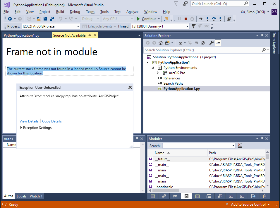

After I attached the debugger to the ArcGIS Pro process, I run the tool, then I 'll see the following error:
Source Not Available and Frame not in module:

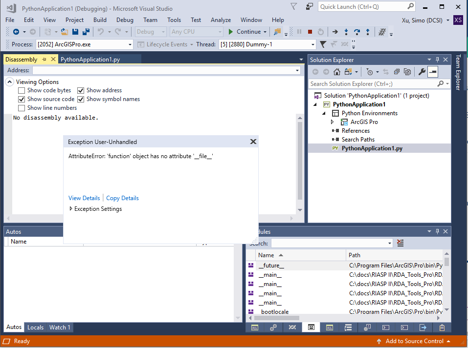

If I Enable address-level debugging--> Show disassembly if source is not available in the Debug-->Options
I'll the following error. To be honest, I don't think this setting make any sense for Python any way.
No disassembly available. (not surprised)

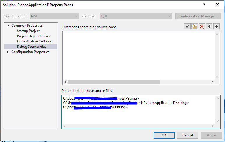

If I check the Solution Property in VS 2017,  I found my source code paths are automatically put into Do not look for these source files!!!
I tried to set the Directories containing source code in the above property window and empty the Do not look for these source files box before the debug, but, after the debug attempt my source code path will be put back in the Do not look for these source files.
