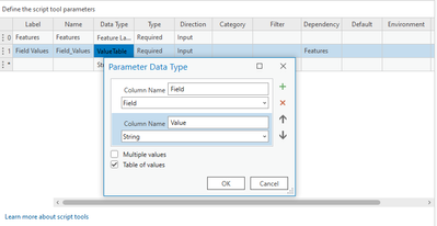

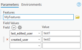

If you make a parameter a table of fields to string values and then make it dependent on the appropriate parameter you can get a pretty functional interface:
