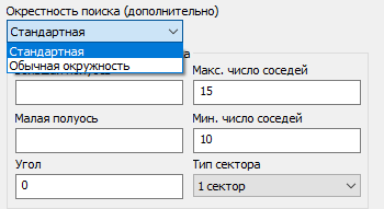

Hello! I'm trying to use the parameter "GPGASearchNeighborhood" in a tool in my toolbox. I noticed that some of the tools in the Geostatistical Analyst toolbox (for example, Radial Basis Functions interpolation method) limit the options of neighborhood types to 2 out of the default 4 - Standard and Standard Circular (sorry that all the text is in Russian)
Does anyone know how can I do that? I tried using filters, but I can't figure out how to use them with GPGASearchNeighborhood.
