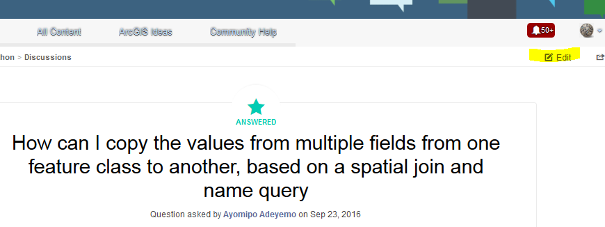

Done.  If you click the Edit button on the top right, you can then edit the title or question.  It doesn't necessarily look like the title is an option, but click on it and you can do it.  For next time.
