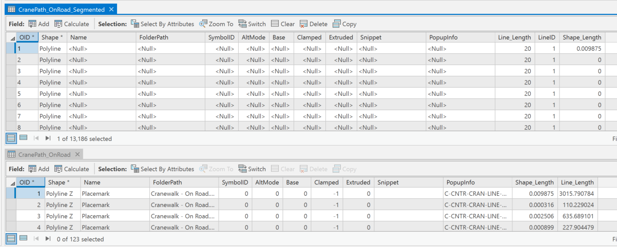

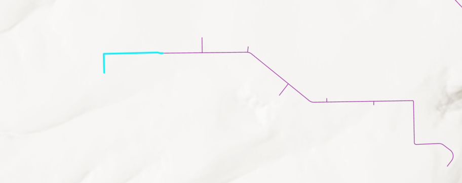

My script is able to successfully iterate through the source polylines layer and add information to an output layer using cursors and segmentAlongLine method. Though the attributes table has the correct number of rows, the feature layer still only shows the original polyline when selected. I believe what is happening is that the segmented polyline doesn't actually exist. Any ideas on what I'm doing wrong? Thank You!

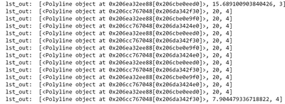

the only debugging that I've done is set a print statement for the 'lst_out' list. Here is a snippet of it:
