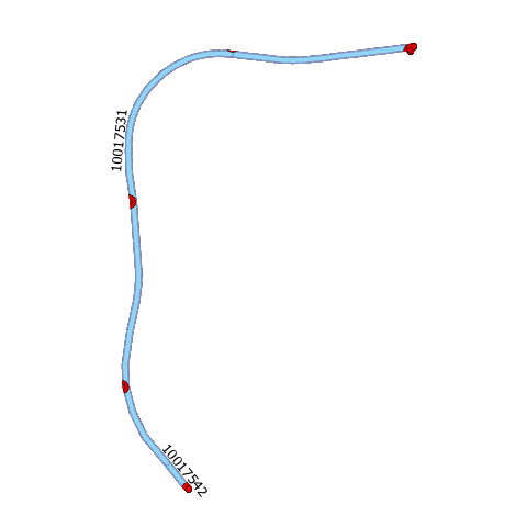

Hi,
I have a script, which works up but does not output the result that I am looking for, where some shared values don't get assigned the unique ID. Some portion of lines are getting separate IDs despite having a shared common point. Here is the script that I have working thus far:

RPGIS
by MVP Regular Contributor
Hi @Anonymous User,
1 [2134344.1859597526, 2134044.6763881706]
2 [2134716.9647417553, 2134344.1859597526]
3 [2134854.214795336, 2134716.9647417553]
4 [2127143.862105839]
5 [2127231.4413270056]
6 [2127231.4413270056]
7 [2127232.538437672]
8 [2127231.4413270056, 2128202.311432503]
9 [2128202.311432503]
10 [2128489.532314755]
11 [2128489.532314755]
12 [2128489.532314755]
13 [2128488.698326919]
14 [2128544.1339115873]
15 [2128544.1339115873, 2128859.5250130855]
16 [2128859.5250130855]
17 [2128859.80782092]
18 [2128859.5250130855, 2129739.475024838]
19 [2129739.475024838, 2130065.4704358354]
20 [2130065.4704358354]
21 [2130052.789030753]
22 [2130065.4704358354, 2130320.071304586]

Hi,
Here is what I have for some of my print statements.
10017531 [27087, 27127, 27187, 27190, 27111, 27128]
10017532 [27088, 27154]
10017533 [27089, 27254, 27255]
10017534 [27090, 27332]
10017535 [27091, 27134, 27135]
10017536 [27092, 90968]
10017538 [27093, 27124, 90965, 27095, 27125, 27133]
10017541 [27094, 27100, 27101, 27103, 27105]
10017540 [27130, 27099, 90956, 27129, 90957, 90962]
10017539 [27096, 27126]
10017542 [27102]
Here is a screenshot for one of the dirtier areas.
by Anonymous User
Not applicable
Without context of what those numbers are in the print statements (ID's, AssignedID's? and start, end?), and not seeing any duplicated assigned numbers that prompted this question, I still think that you will need to step through your code with a debugger to figure out when/why/how the assignment is happening.
Replace these numbers with the numbers that are 'wrong':
if ID == 10017531:
  # put a break point here and step through it
# or
if start in [27087, 27127, 27187, 27190, 27111, 27128]:
RPGIS
Hi @Anonymous User,
Here is an updated print statement, but I am working, as you suggest, debugging using line breaks. I haven't used those at all so I am trying to configure it as such.
93169 is already assigned 10040713 as isolation ID.
93169 is key in IDValues dictionary with floating [2203858.366813004, 2203850.9137439206] X coordinates as values
The floating 2203858.366813004 is the key in LineValues dictionary with [93168, 93169] line IDs as values
93168 has been assigned 10040713 as value.
93169 has been assigned 10040713 as value.
The floating 2203850.9137439206 is the key in LineValues dictionary with [93166, 93169] line IDs as values
93166 has been assigned 10040713 as value.
The previous print statement is from a dictionary in which the IDs and Assigned IDs are inverted. Hopefully this gives more detail and in the meantime, I am working on utilizing the line breaks and debugging as I go.
