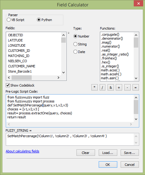

I want to -simply- compare the values from three columns using Fuzzywuzzy python library and return the percentage value.
I want to do something like this, but of course, this function is not working!
How I can make this one work.
from fuzzywuzzy import fuzz
from fuzzywuzzy import process
def function(query,v1,v2,v3)
choices = [v1,v2,v3 ]
result= process.extractOne(query, choices)
return result

I don't have time to look at fuzzy string part, but there are some other issues I see.  First, you don't have a colon after your function definition:  def functioname: .  Second, your not doing any indentation with your function definition.  Third, you are passing 4 columns to the function, but the function only has 3 parameters.
JoshuaBixby
MVP Esteemed Contributor
In your code, you are using extractOne, which returns a tuple with the highest-ranking string and its score.  What do you want to store in the FUZZY_STRING field?  A string, a number, both?

I update the code to this and it worked for me
def SetMatchPercenage(query,v1,v2,v3,v4):
       choices = [v1,v2,v3,v4]
       result=str(process.extractOne(query, choices))
       return result
