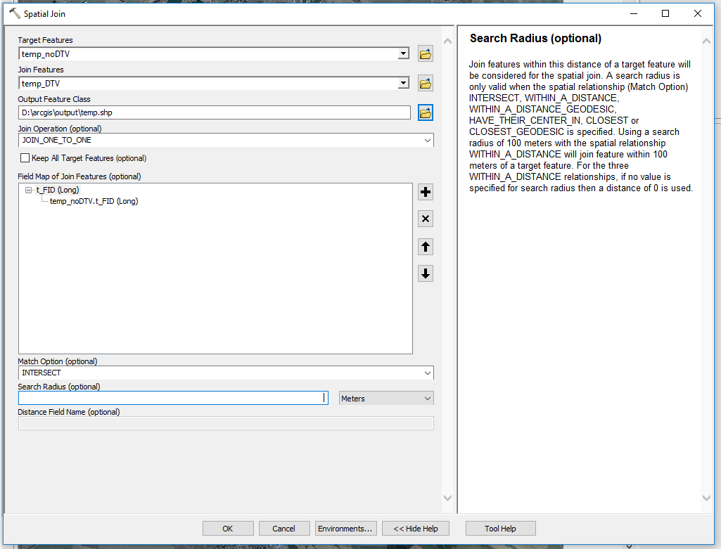

At first a screenshot of the spatial join window showing all the settings i was using:
Screenshot of the working Spatial Join tool settings in ArcMap

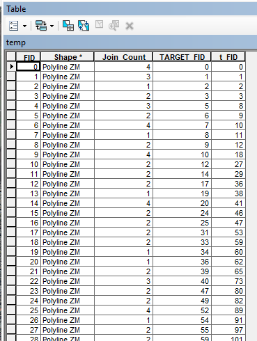

next is a screenshot of the attribute table of the output shapefile, as you can see the last column shows all the correct values:
output attribute table after the Spatial Join
