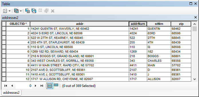

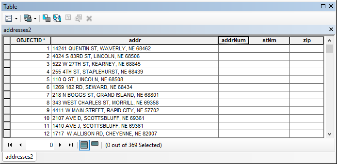

Here's what the testing input table looks like before:
before
And after:
after
My goal is to write the records that error out to a separate table.  (Errors include situations where multiple areas of an address have the same label, like "5318 S 86 CT APT 3 APT 412, Omaha, NE 68137" - multiple APT entries, or "PO Box 291 PO BOX 291, Genoa, NE 68640" - multiple PO Box entries.)  I've reviewed the examples in the error handling page, but they seem to be very focused on geoprocessing.
