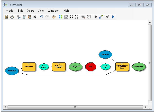

I am running Desktop 10.2.2.  I have been using model builder for years, creating models and exporting them to Python to automate tasks.  Recently, after a number of process failures due to broken connections, I have been trying to upgrade them to validate connections and results before continuing to the next steps.  What I wanted to do was simply check that a feature class was not empty before attempting to process it.  For test purposes I made a very simple model to check the row count on a polygon feature class and if it were greater than 0 copy it to a new feature class.  If the count was 0 it should stop.  Really simple.
As a model it worked perfectly, so I exported it to Python.  That produced this:

Why, why, why can't Model Builder export Python code that actually works?  What is the point of a WYSIWYG GUI that doesn't produce functional code?
So, something is wrong with the expression.  What exactly would that be since it works in Model Builder?  This should be easy.  All I want to do is validate that there is data to process before processing it.

Do you want to execute this as a Python script, or as a ModelBuilder tool? ModelBuilder is great as a starting point but (as you notice!) doesn't always make functional Python, let alone efficient/elegant scripts. Conditionals are a particularly kludgy workflow within ModelBuilder, in my experience.
You can do a fairly straightforward if/else conditional using the row count:
result = arcpy.GetCount_management(TestPolys)
count = int(result.getOutput(0))
if count > 0:
    arcpy.FeatureClassToFeatureClass_conversion(TestPolys, TestData, "TestPolys2")
else:
    print("there are no features in this feature class")‍‍‍‍‍‍‍‍‍‍‍‍‍‍
(Note that the FeatureClassToFeatureClass syntax can be much simpler and cleaner than ModelBuilder exports it as, too!)
