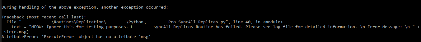

In trying to migrate Python Scripts from ArcGIS Desktop Python 2.7.x to ArcGIS Pro 3.x, we email staff if there is a failure on a routine. Below I am running a sync replica routine using ArcGIS Pro, deliberately breaking it on the file path to the database connection string so it will email a failure. Somewhere in migration, it does not like the email code that has been working for years now. Has anyone else had to upgrade email failures from 2.7.x to 3.x in Python? With using the correct file path, the routine was successful. We use Windows Task Scheduler to run Python routines.
I receive the error (server name omitted for security):

Looking at the screen grab, it looks like the error is in the following line:
 text = "Routine has failed. Please see log file for detailed information. \n Error Message: \n " + str(e.msg)
You are trying to call the "msg" of the exception.  You should be able to just call e to get the result you are after.

Thank you, Michael, that did work. This will be helpful as we will have parallel Python environments of 2.7.x and 3.x until we can fully migrate to ArcGIS Pro.
