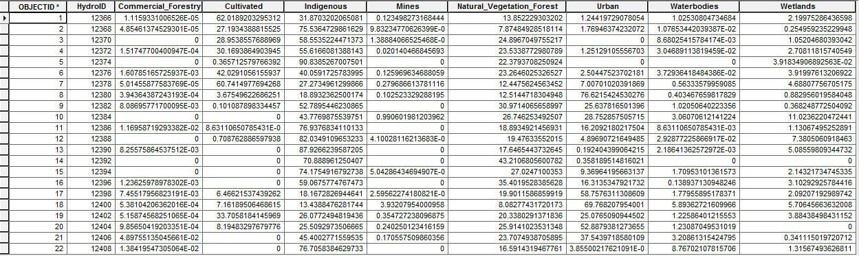

Landuse: Updated Table using second Python Function
So any help how to loop through each each instead of having to manually specify the index position will be appreciated.
