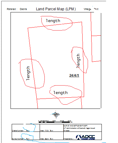

This is the image.  I have to update the SNO, Chalta_No, and Village filed as "Survy no", "ChalataNo" and Village in the layout view automatically. Can you suggest me?
RebeccaStrauch__GISP
MVP Emeritus
The Data Driven Pages should be able to do all that.​ Using dynamic text with Data Driven Pages—Help | ArcGIS for Desktop   explains how to use it for dynamic text elements.

Is it possible can we calculate length of line in the polygon feature class.
RajP
I would like to print the length of polygon in the layout view.
