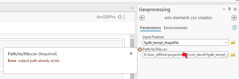

Tentatively found a solution.  Any alternatives to the conditional logic: if parameters[1].value would be greatly appreciated!  But it works.  Code is commented to explain why I did this.
    def updateMessages(self, parameters):
        """Modify the messages created by internal validation for each tool
        parameter.  This method is called after internal validation."""
        # This if statement required or else error message will for parameter[0]
        # "TypeError: stat: path should be string, bytes, os.PathLike or integer, not NoneType".
        # Apparently this method will run through ALL parameters right off the bat.  So add
        # conditional statements to ensure validation only performed on target parameters i.e. parameter[1] in this case
        if parameters[1].value:
            fp_csv = parameters[1].valueAsText
            if os.path.exists(fp_csv):
                parameters[1].setErrorMessage('output path already exists')
            else:
                parameters[1].clearMessage()
        return
Note that when an existing path/to/file.csv is passed for argument 2 (parameters[1]), the message will display:

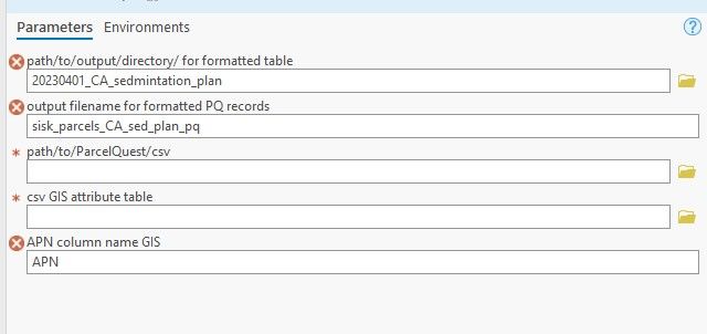

ZacharyUhlmann1
Perhaps a new post is in order.  Do either of you have experience defining an argument as a DETextFile or DEFile?  For another Python Toolbox built on the same template you all helped me with (thanks!), I want to pass a path/to/csv as an argument.  Spent the hour fleshing out, copying and pasting the .pyt.  Looks good.  Tool opens, but when I select (or try to select) the input csv in both the third and fourth arguments, it doesn't load - argument input box(es) stay blank.  I've tried manually copying the path/to/file.csv into the argument, csv GIS attribute table in this case.  Same thing.
When I try running the tool I, an error is thrown about NoneType as would be expected.  My first instinct is to think an ESRI bug, but I'll withhold judgement until digging.  Just trying to pass a file as an argument.

Super late response, but I had the same problem yesterday and it was because my two parameters had the same name.
