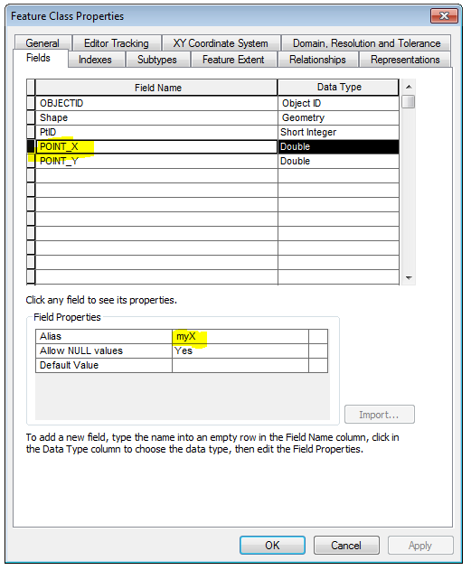

Although not Zen, I agree with Dan that using "#" is acceptable, since it goes way back to the AML days (i.e. '80s" anyway).
arcpy.AlterField_management(r'C:\__temp\test.gdb\newpts', "POINT_X", "#", "myX")
In commands, if I need to use the default or not change a value, I try "X" first, if that doesn't work ""  (i.e. double, empty quotes) sometimes works too.
