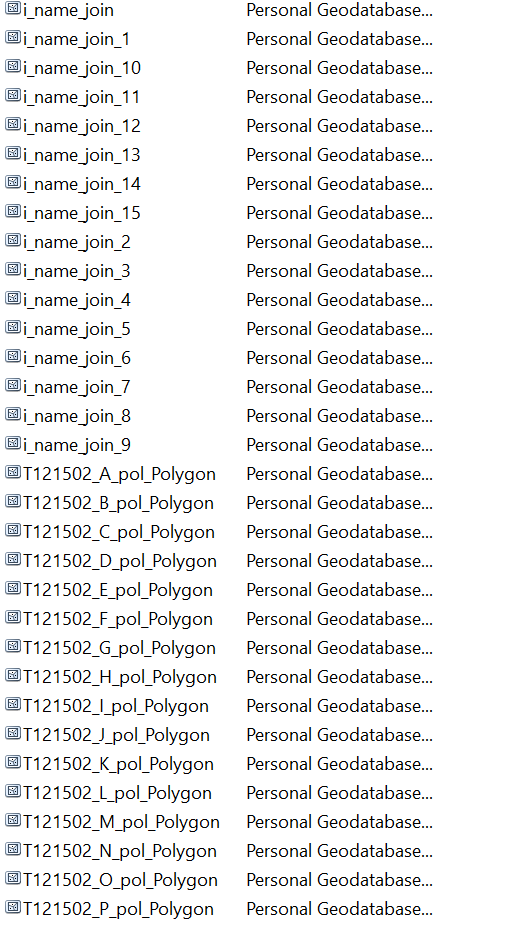

I wanted to have the same name of the input join features after the join. The problem is that, to have a join, I need to use the arcpy.MakeFeatureLayer_management. I've been unable to give each layer the name of the original feature. The join works, but in the end, instead of having a feature named T121502_A_pol_Polygon (and son on), the join features that result from the script are named (in this case) i_name_join (and so on). Is there a way to change the cript in order to get that result?

I also tried it. But the problem remains. Maybe the picture isn't clear. The «i_name_join_*» features are the result of the script. The «T121502_**» are the input features. They are the ones de «describe» is getting. What I would want is to have in the end, if possible, is:
original inpuit feature name «T121502_A_pol_Polygon»; result of the script «T121502_A_pol_Polygon» and not what i'm getting - «i_name_join»
I'm about to give up and use the result as is 😞
