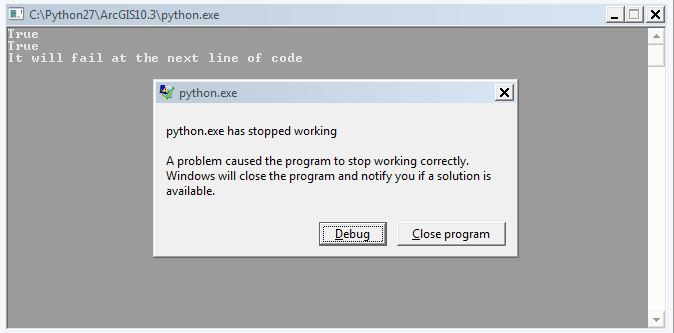

Hey All,
I have ArcMap installed at version 10.3.1 and I have several automation scripts, and I have recently noticed all my scripts that use arcpy.ListFeatureClasses() fatally error out at that tool.
Is someone else able to confirm they are able to run this without any critical errors?
I have just used the below code to test it bare basics, if someone else could please assist by changing the three variables to suit, does it run successfully?
import arcpy
connection = r"Database Connections\GISADMIN@[email protected]"
arcpy.env.workspace = connection
test_dataset = r'Database Connections\GISADMIN@[email protected]\SDE_SPATIAL.GISADMIN.Airport'
test_feature_within_dataset = r'Database Connections\GISADMIN@[email protected]\SDE_SPATIAL.GISADMIN.Airport\SDE_SPATIAL.GISADMIN.Airport_Lighting_Zones'
print arcpy.Exists(test_dataset)
print arcpy.Exists(test_feature_within_dataset)
print 'It will fail at the next line of code'
print arcpy.ListFeatureClasses(test_dataset)
print '\n\nTEST COMPLETE'‍‍‍‍‍‍‍‍‍‍‍‍‍‍‍‍‍‍‍‍‍‍‍‍‍‍‍‍‍‍‍‍‍‍‍‍‍‍‍‍‍‍‍‍‍‍‍‍
Fatal error
I am considering updating my machine to the latest version, but before I take this step I am hoping someone can confirm it doesn't work at this version?
Thanks very much for your time.

Sorry I didn't expand on what was happening, if I run in catalog python window it was returning an empty list, but if I ran a standalone python window it would crash as per my original post and screenshot.

That single line of code crashes arcCatalog when I run it in the Python Window:
print arcpy.ListFeatureClasses('SDE_SPATIAL.GISADMIN.Airport')
This line works perfectly:
print arcpy.ListFeatureClasses(feature_dataset='SDE_SPATIAL.GISADMIN.Airport')
This script was working fine for over a year, I think the problem started when we updated from 10.3 to 10.3.1, but I cannot be 100% sure, it could be coincidental.
