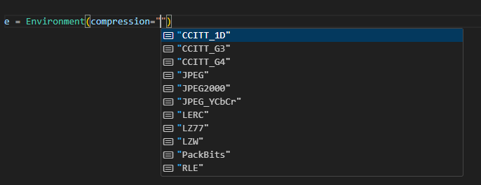

I pretty frequently find myself using tons of magic strings and flip flopping of environment variables in my scripts.
I have implemented something that does this as best as I can here  as an example solution. It's essentially a carbon copy of the EnvManager class but with explicitly defined environments so a static type checker can help you make sure you're feeding correct values and parameters to the GPEnvironment object.
This could also be implemented in a .pyi file for EnvManager.py to allow for forwards compatibility with changes to env parameters and type hinting updates could lag behind without causing issues.

Well, I'm dumb. At least this is still useful for the type hinting and auto completion/literals lol.
Updated the title to reflect that.
