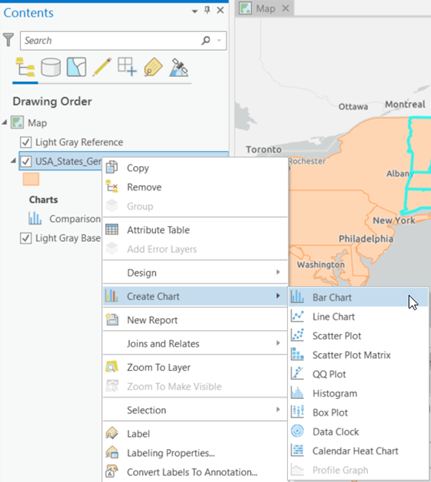

3. Before we work on our notebook, we will visualize the population of US states with a chart to get an understanding of our data. Right-click the USA_States_Generalized layer in the Contents pane and select Create Chart > Bar Chart.
4. In the Chart Properties pane, under Category or Date, choose the Name field from the drop-down list. Under Numeric field(s) check POP2010. Leave all remaining options as default and click Apply.

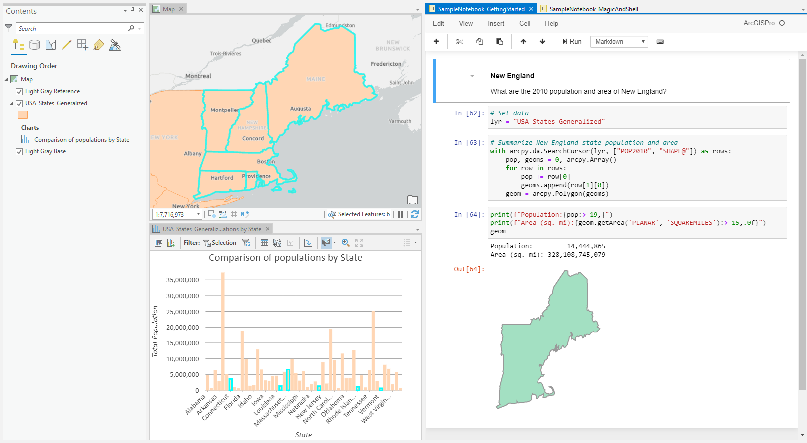

6. From the Map ribbon click the Select button and select the states Maine, Massachusetts, New Hampshire, Rhode Island, and Vermont.
Notice that selecting features in the map also highlights the corresponding data in the Chart. We can see the relative size of the populations of these individual states compared to other states. We would like to report the total population and area of these five states. To do that, we will use the notebook.

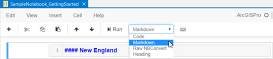

8. Select Markdown from the drop-down list above the cell, and then press Shift+Enter to run the current cell and simultaneously create a new cell below.
The text becomes a header and description for your notebook. Markdown allows you to narrate a notebook and break it into sections.

The code iterates through the selected population and geometry records of the USA_States_Generalized dataset. It totals the population and stores the result in the pop variable. While iterating, it also combines the geometries of the individual states into a single arcpy.Polygon object stored in the geom variable.
11. In the next cell, enter the following code and press Control+Enter, this will run the cell without creating a new cell below.
print(f"Population:{pop:> 19,}")
print(f"Area (sq. mi):{geom.getArea('PLANAR', 'SQUAREMILES'):> 15,.0f}")
geom‍‍‍‍‍‍‍‍‍‍‍‍‍‍‍‍‍‍‍‍‍‍‍‍‍‍‍
The code prints out the population and area of the five selected states. Thanks to rich representations in notebooks, the geometry of the five states is also displayed directly in the notebook. The result is a document that reports the population and area of New England states, and shows a visual representation of the five state's combined shape.

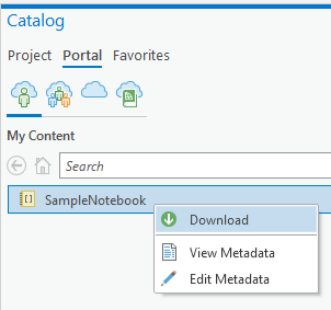

  • Using Notebooks hosted on Enterprise Portal in ArcGIS Pro: There are several options for moving a hosted notebook to your local machine.
    • Make sure you are signed into a portal. From the Catalog pane in ArcGIS Pro, go to Portal > My Content, right-click a notebook item, and select Download.

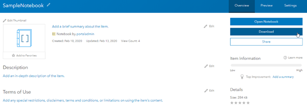

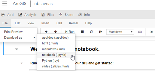

  • Signed into Portal on the web browser. From the Notebook Editor in Portal, on notebook menu ribbon, click File> Download as > notebook (.ipynb).
  • Signed into Portal on the web browser. From the notebook's Item Details page (accessible from the Content tab by clicking on a notebook item), click Download to download the notebook in .ipynb format.

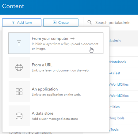

    • You can upload any notebook file (.ipynb) to your portal. Sign into your organization's Portal from the browser, go to the Content tab of the contents page, click Add Item > From your computer and choose From my computer. From the Add an item from my computer dialog, click Choose File and browse to a notebook file on your computer, provide a title and tags, and then click Add Item.
