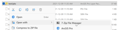

Besides 7-zip's 7z.dll can be seen in C:\_install_folder_\bin, so maybe it is installed besides my already installed version.  Opening up an *.lpkx file confirmed my suspicions  7z!   BTW, there are webpages listing what to look for as magics in the first number of bytes of a file, but that is for another blog.
So I unpacked my layer file to see what was in the layer package.
The next 2 images show the process of making the layer package.
Then I gave it a shot of seeing what was inside using 7-zip

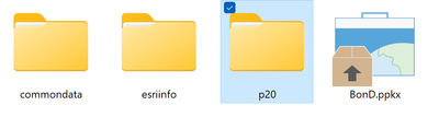

And to my surprise there was a whole bunch of stuff inside, and the sample shapefile I used was contained in a folder.  The other folders had other stuff in them which might have been useful to some

Back!  works for packed projects even packaging my gdb and toolboxes
