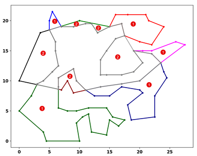

  • Take 2 polygons.
  • Overlay them.
  • Get their intersection points.

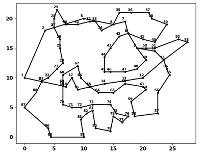

  • Renumber the points so that intersection points have the same ID value
  • Determine the points that are inside and outside the other.
  • Form sub-polygons which can be used for
    • intersection
    • clip
    • symmetrical difference
    • union
    • concave hull
    • and much much more
polygon A                                    polygon B                                     A over B
Now "intersect" and combine the geometries
looking easy so far, so produce a list of from-to point ids
polygon A          polygon B
   fr  to  i/o    i/o   fr   to   fr   to
[[  0,  3,  -1,     1,   0,   7,   0,   3],
 [  3,  4,   0,    -1,   7,  11,   3,   4],
 [  4,  6,  -1,     1,  11,  17,   4,   6],
 [  6,  8,   1,    -1,  17,  25,   6,   8],
 [  8,  9,   0,     1,  25,  34,   8,   9],
 [  9,  11,  1,    -1,  34,  39,   9,  11],
 [ 11,  15,  1,    -1,  39,  51,  11,  15],
 [ 15,  19, -1,     1,  51,  57,  15,  19],
 [ 19,   0,  0,    -1,  57,   0,  19,   0]])
Now, the first 3 columns belong to polygon A and they contain the segment from-to ids and whether the segment is
  • inside (1),
  • outside (-1) or
  • on (0)
the other polygon.
Columns 3, 4 and 5 are the same for polyon B, but I just switched the i/o column so that both i/o columns were side by side.
The last 2 columns are columns 4 and 5, renumbered to match the common id values of polygon A.
Now the cool thing is, is that if the overlapping segments progress in a simple progressive pattern around the shapes, all the sub-shape components can be easily identified and obtained.
So can you see the components bits?
