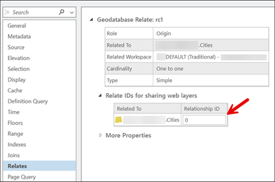

Thanks@MatthewStull1 for adding your note here. You are right, this is fixed for both map service and feature service in 11.3.
Once you have both sides of a relates in your map in Pro, if you open the layer/table's Properties page and go to Relates tab, you will see an option to provide user defined ids for relationships.
Note: please note that we have an issue -- if you already have 'allow assignment of unique ids...' option checked at the map level, and you added the layers/tables; you might not see this option; You need to reset (or toggle it if you wanted to preserve your already assigned layer ids) that at the map level to see this text box to enter your desired id.
We apologies for this issue; we are hoping to fix this issue in a future release.
