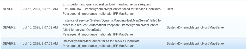

In the logs I see a lot of the following error for many different webservices:
  • CreateDynamicMapService failed for service "..."
Unfortunately, even when setting the log level to "Fine" there is not more information.
