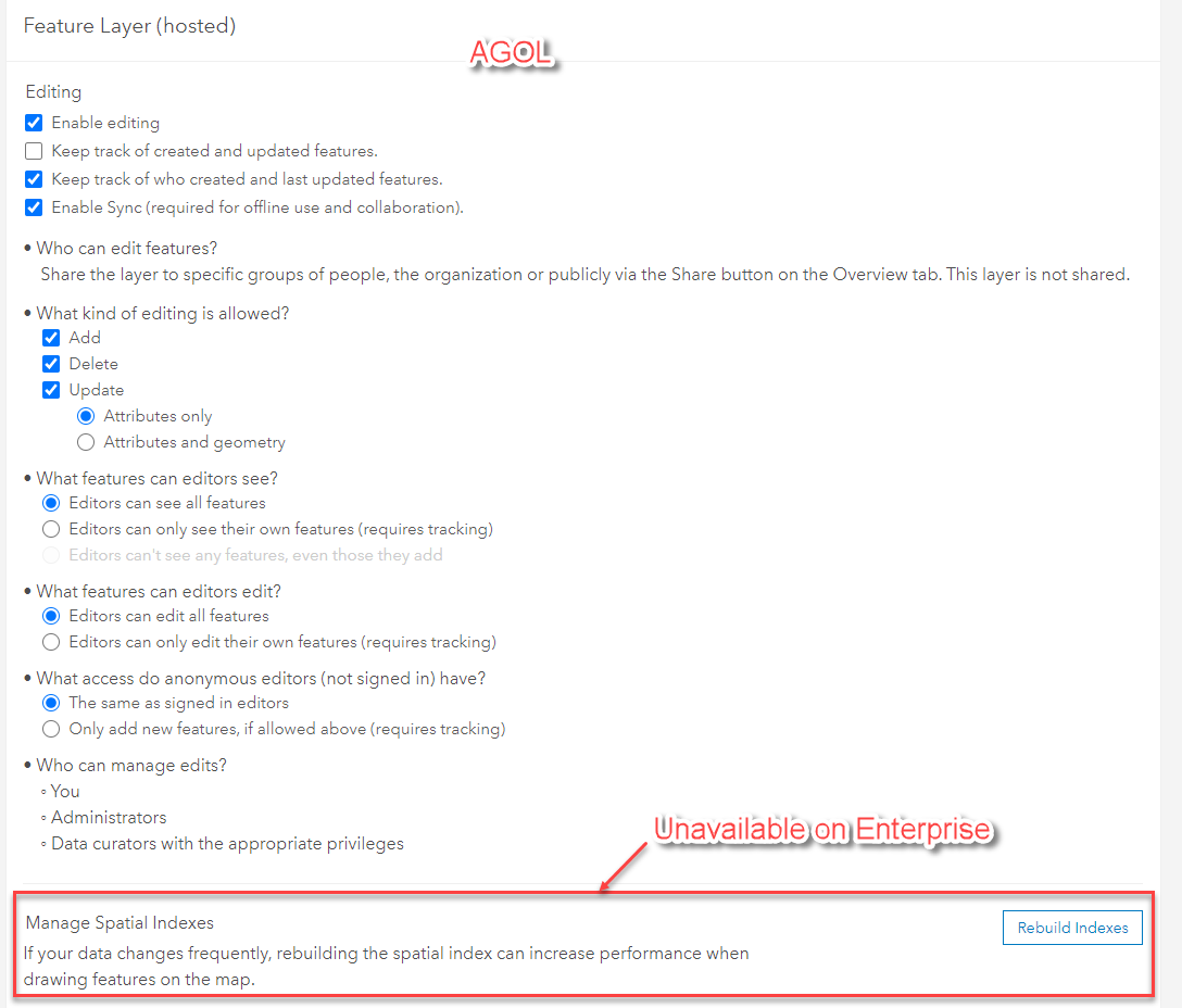

Enterprise 10.9.0. Hosted feature layers with frequent data updates. Need to rebuild spatial indexes on a regular basis.
When using AGOL, there is an option in the portal item settings which rebuilds the spatial index to improve performance. The option is not available on Enterprise.
What are the common ways for rebuilding the spatial indexes for hosted feature layers on Enterprise?

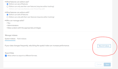

I'm resurrecting an old post.   I'm encountering the same issue on our Enterprise 11.x install.   I cannot figure out how to enable the rebuild indexes for managed layers.   Any ideas?
GB_-_IanHogan__INFORM_
Same issue, did you have any success? We have hosted feature layers in AGOL. The  "Rebuild Spatial Index" option just hangs, and once it's hung, it is never available again. It will report a "Creating index: Indexes may take a moment depending upon the amount of data." message, one of which I've had now for a month.

We just updated our environment to 11.4 and the rebuild spatial indexes option is available on a HFS.  We updated from 11.1 where the option was not present, I cannot speak to 11.2 or 11.3.
