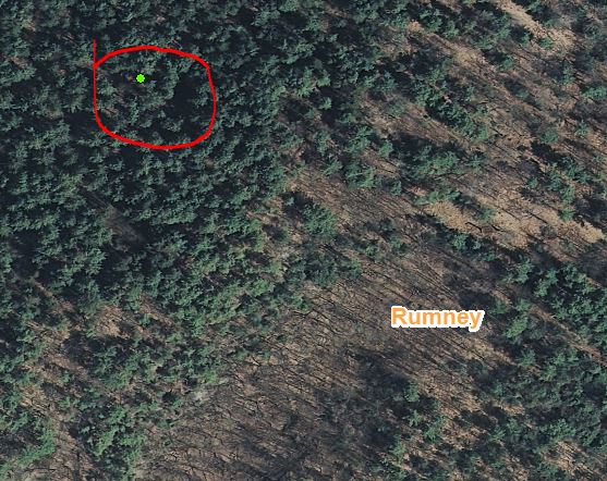

Does anyone know how to change the icon for the 'Go to XY' function, Add Point?  The default is a green small circle and it sometimes difficult to discern in forested imagery.  I use this function frequently and would like something bigger and with a more contrasting color

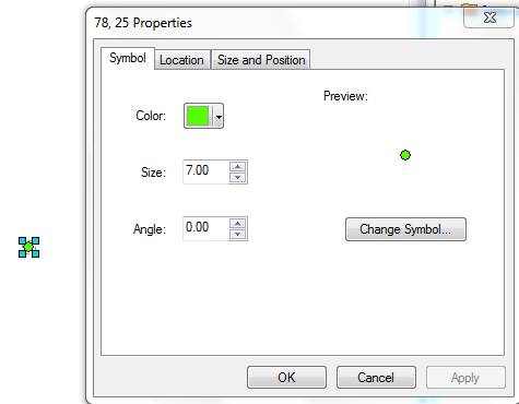

Double-click the point created from the GO TO XY tool. You can change the properties
