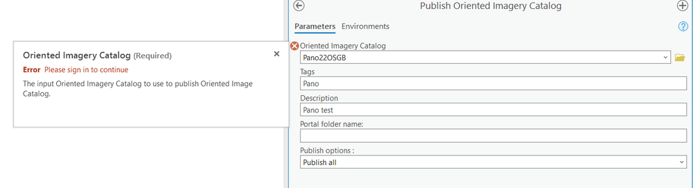

When trying to publish an oriented imagery catalog I get a message stating - Error Please sign in to continue.
I am signed into the portal as an Admin.
Pro 3.2.1
Enterprise 11.1
Image MGT Workflows tools V 2.14

Hi Charlie
Can you check that the portal you are trying to publish to is the active portal.
Randall
CharliePoate
Hi Randall, the portal is active. We have multiple instances (Dev/Test/Prod) all at 11.1 and I get the same error with all of them. I have recently downgraded to Pro 3.1.4  so I will test again to see if it has been an issue between 3.2.1 and enterprise 11.1.
RandallRebello
hi Charlie,
Are you able to access items on your portal?  It could perhaps be an access issue. Also check if your user account has permissions to publish.
Randall

RandallRebello
Hi Charlie,
What kind of authentication are you using for Enterprise? Also can you also try out a couple lines of python code for me. You can send me the results via a direct message.
Open a python window from  the Analysis window in Pro.
Type in and run this code.
from arcgis.gis import GIS
GIS("Pro", verify_cert=False)
Send me the result. Just need to know if it created this successfully..
Next run this line
arcpy.GetSigninToken()['token']
it should print out a token. let me know what it does.
I checked with our developers.. and basically if it cannot get a token it will show that message.
