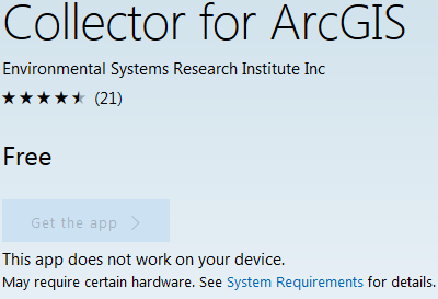

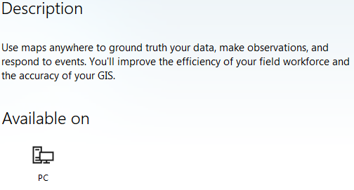

Hello again Derek,
According to the Collector for ArcGIS - Microsoft Store link, the following is what shows on my phone:
I can't find any link for the Windows Phone.

Hi Matthew,
Apologies for the late reply, I was on business travel last week.
I'm also sorry, but I made a mistake in my previous post. As you pointed out, Collector for ArcGIS is NOT available on Windows Phone at this time, it's only available on Windows 10 tablets and PCs. I am sorry for my mistake.
