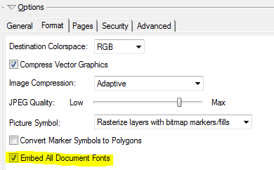

I can click the text in the PDF I entered in a TextBox of the Map.
Click on "Embed All Document Fonts" in Export Map option.

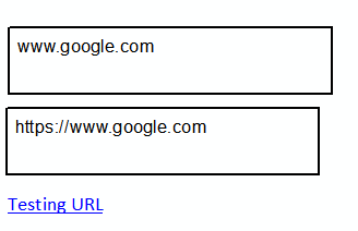

In fact, I am able to click the text in PDF doc to open the webpage, even if the above option is unchecked.
Is the text that you are entering is a recognizable URL only, or it has additional text as well?
Screenshot would be helpful.

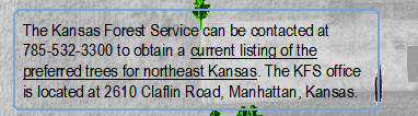

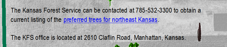

Thanks for your help. This is what the text block looks like in my  map. If you double click it, it opens MS Word, where the underlined section is a URL.
I think I realize what my question is more clearly now, which is how do I embed the URL. In the picture below, the top two links work, but the last one doesn't. I don't want to show the URL to my viewer. I want them to click on a text.

I do not want the URL to be in a table or a field. I know how to make it clickable if it is data or content in one of the tables. I just want to insert a simple text box, and make part of the text clickable. In the text box below, I wanted the underlined section to point to the dept of forestry website.
I'm using this tool to generate the text.
