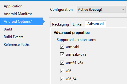

PreetiMaske
Can you please check that project properties > Android Options> Advanced Tab has the architecture that matches the architecture of the mobile to be checked ON. See image above for reference.
Let me know.

PreetiMaske
Hope you see the image now. This is the image I was referring too. But I guess you got what I was asking to check.
Ok so, does the app work/deploy in release mode? As an FYI, there are some issues with arm64-v8a architecture that are currently under investigation. Would it possible for you to uncheck arm64-v8 and test running/deploying your app?

MichaelBranscomb
Esri Frequent Contributor
Hi,
To summarize the discussion so far:
- In debug mode you see: System.NotSupportedException: Could not activate JNI Handle 0x7fca1a7480 (key_handle 0x2ad6405) of Java type 'Esri/ArcGISRuntime/UI/MapView' as managed type 'Esri.ArcGISRuntime.UI.MapView'.
- In Release mode you see: "Unfortunately, <your app name> has stopped."
Please can you confirm for both Debug and Release modes what options you have enabled on the Packaging and Advanced tabs under Project Properties > Android Options? (i.e. 4 images similar to the image my colleague Preei posted above).
Note when your Android app is set to build/deploy as Debug, by default all CPU architectures are enabled but note these will be ignored because the `Use Shared Runtime` and `Fast Deployment` options are enabled (in Project Properties > Android Options > Packaging tab). When your app is set to build/deploy as Release, on the Android Options > Advanced tab, by default just armeabi-v7a is enabled. For more information please see the Xamarin doc on this subject: CPU Architectures - Xamarin.
Currently we do not support arm64-v8a as a target architecture in debug or release, but apps built for armeabi-v7a will work on both 32-bit and 64-bit ARM devices.

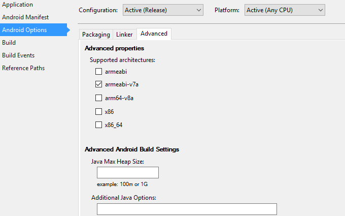

NadirHussain
Dear Sir
the above image is the settings for debug and for release mode is setting is in below image.what can be the reason i cant debug my application.Because if i make same settings for debug mode my application. i could not create package i cant install.if i make same settings like release mode in dubug process my application not load in emulater not come to visible mobile device.please help we have already lost lot of time.
MichaelBranscomb
Hi,
The debug and release settings for 'Supported architectures' look ok. If you create a new Android application from the ArcGIS template do you see the same problem?
