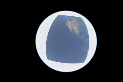

I asked a similar question once (File Geodatabase Not Loading Properly on SceneView), but since I couldn't get a useful answer and there are now more details on the problem, I want to ask this again.
Problem: When I try to load a map, image, file geodatabase etc. using LocalServerArcGISMapImageLayer (the function I used is provided below) on a scene, only a small part of the map is shown (part of North America & Pacific Ocean) as seen in the image below:
RuntimeHata.png(This is a basemap image that  should cover whole earth surface)

I finally figured out that the file (EMPTY_MPKX_PATH) passed as a parameter while initiating LocalMapServer has not proper extent. After creating a new mpkx file that covers whole world, I managed to load scene properly.
